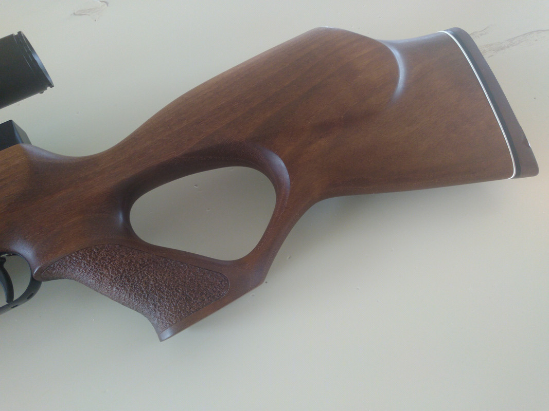

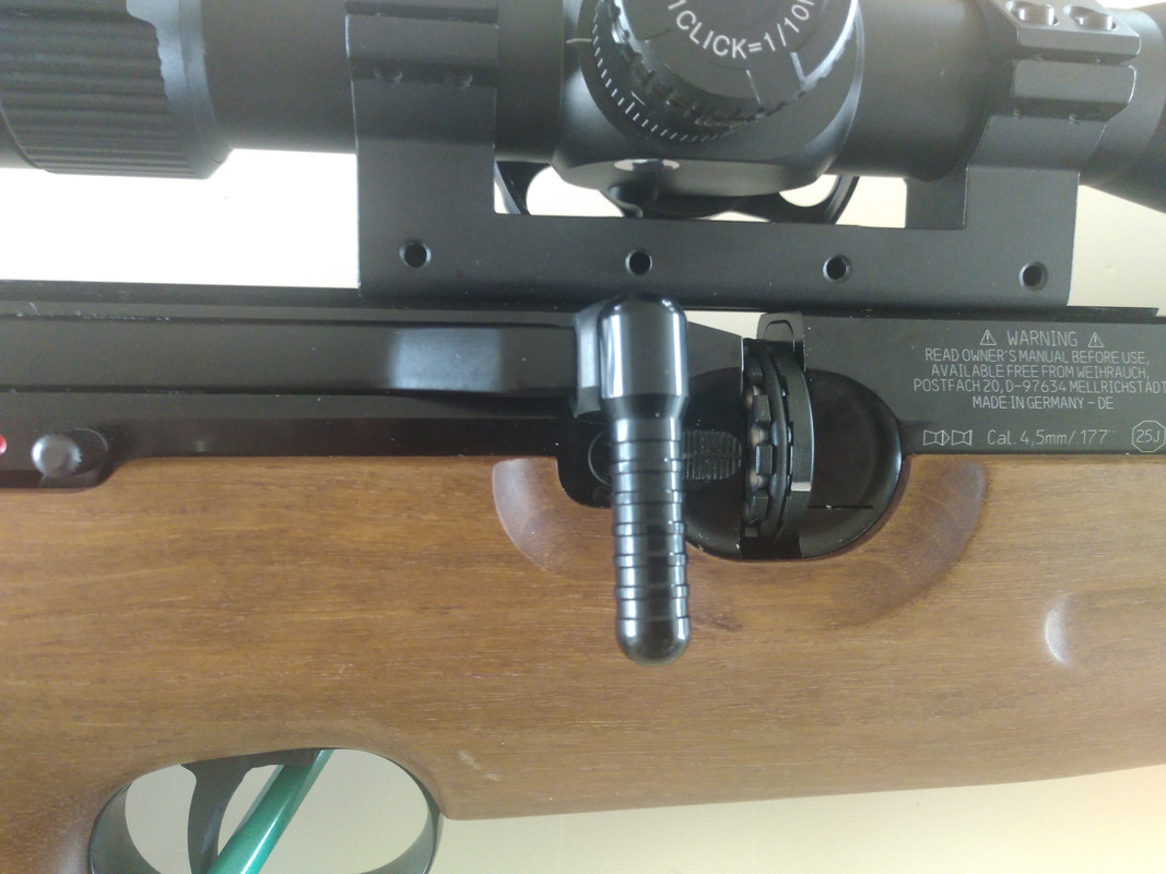

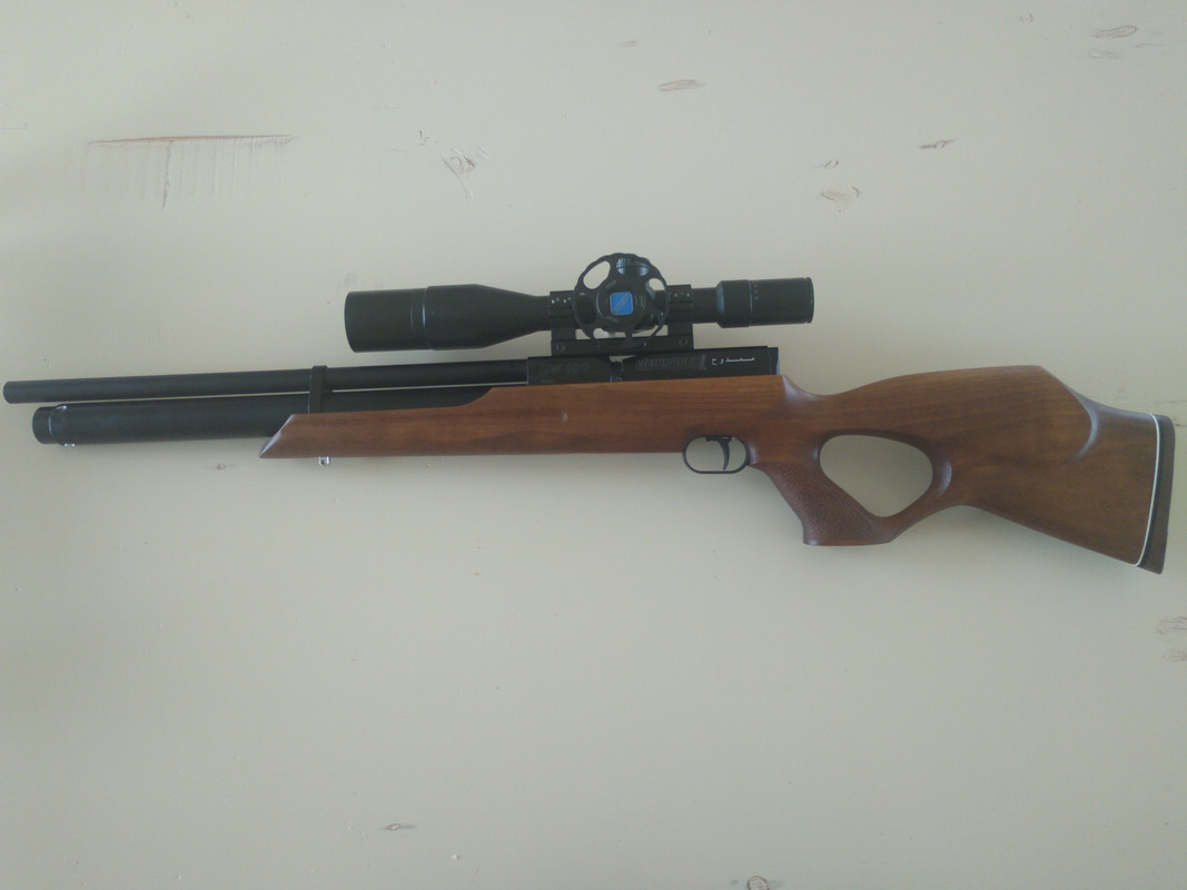

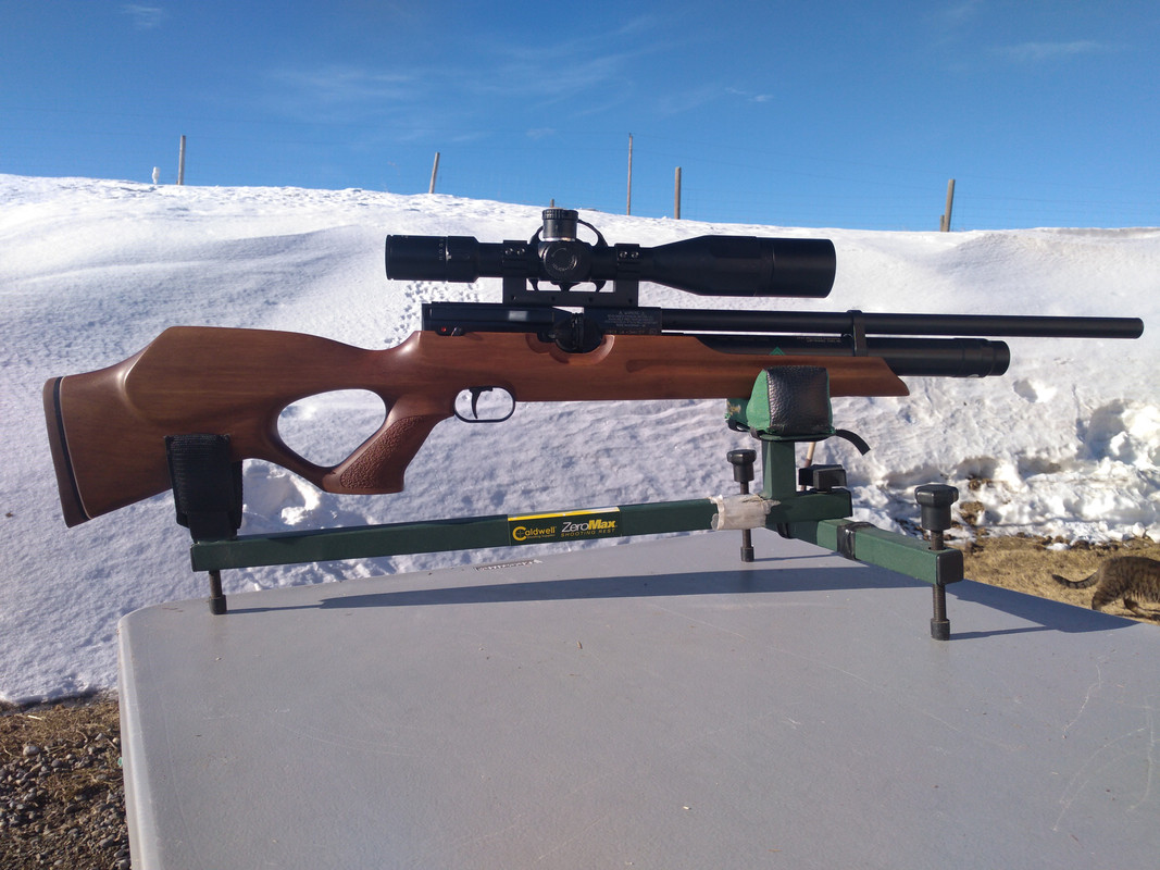

Here are a few pictures. I also put a biathlon lever on the cooking handle. Crazy how much more comfortable it makes the cocking action.

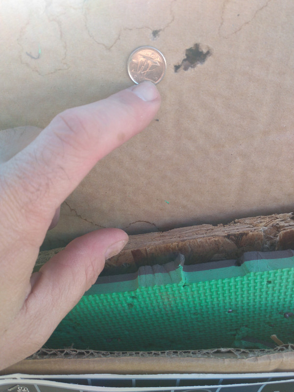

The picture of the shot group is one pellet for aim point and 13 remaining shots in one dime sized group at 40 meters, in a left to right wind
