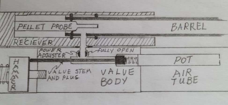

This crude and so not to scale drawing shows the layout of the main parts.
Bore ID is 0.25”, bore area is 0.0491sq. in.. Pellet probe OD is 0.1190” and I plan to reduce that to 0.0787” (2mm) for a probe area of 0.0049 sq. in.. If we subtract the probe area from the bore area we get an area for air flow of 0.0442 sq. in. or the equivalent diameter of 0.2372” or 15/64” a common drill bit size. Therefore my goal will be to open all ports to a diameter of no less than 15/64” or it's equivalent area which is 95% of bore. The valve seat ID is 0.1320” or an area of 0.0765 sq. in. and the valve stem has an OD of 0.1551” or an area of 0.0189sq. in. Subtracting the stem area from the seat area we have 0.0576sq. in. which is larger than my goal of 0.0442 sq. in. so I'm OK there.
The other ports have an ID of 0.0158” so they will be drilled out to 15/64”.

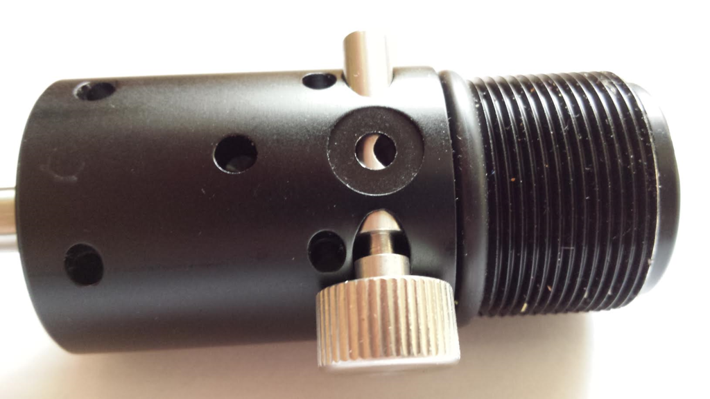

The barrel port will need extra attention because if I were to drill that large a hole through it the front of the pellet would partially fall into it and be deformed before it gets fully chambered. So I'll drill the barrel port most of the way through but not into the chamber. Then I'll use a dremal bit no wider than the original port hole to elongate the port hole on the chamber side so the resulting air flow should match the other ports and the pellet will pass by unscathed.

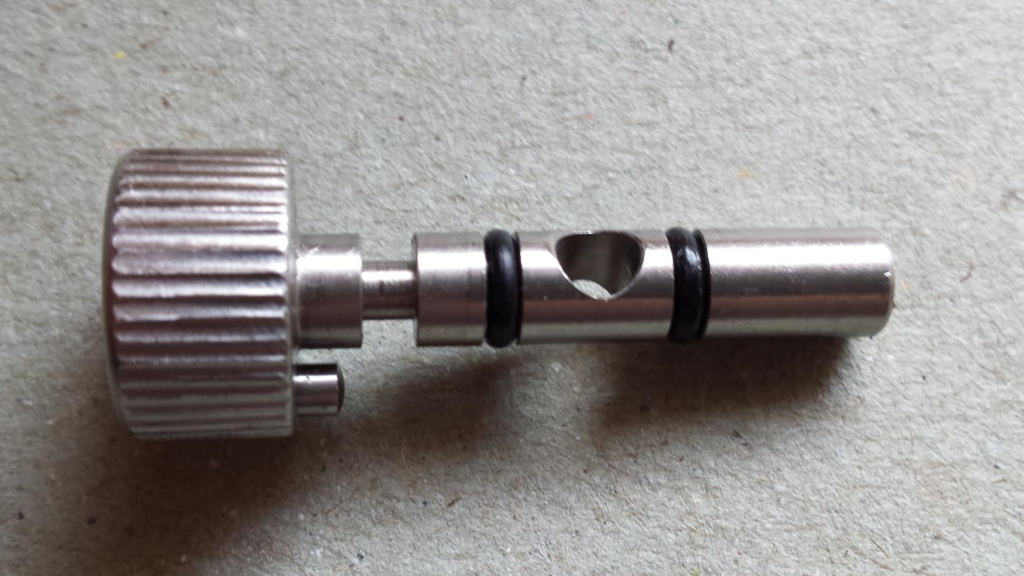

The power adjusting port will be a challenge since the shaft's diameter is less than my target port size. I can't just drill through because the resulting two halves would go fling out on the first shot. Also I can't replace it with a larger diameter shaft because there is no room in the valve body.
I plan to turn down an aluminum rod to fit snugly into the adjuster shaft hole. It would be held in place by a screw on either side of the not yet drilled port hole. Also I'd use epoxy for extra strength and sealing although I'm not sure if epoxy is the best choice there. Then I could drill through the valve body and aluminum rod to form the port. I never would have used the power adjuster anyway.

After going over the numbers and measurements I found that porting to 15/64" would have been too aggressive. The tolerances in the valve body and the barrel were tight and too risky so I went with the next smallest drill bit in the set 7/32" or 0.2188" which is nearly 80% of bore. Not bad when you consider the original ports were less than 40% of bore. This meant the power adjuster could stay in place but barely. I drilled it out until there was very little metal left on the sides. This meant that even at it's lowest power setting it would only slightly reduce velocity but that may come in handy when fine tuning for accuracy. I also used a file to expand the hole by elongating it until it's area was equal to that of a 7/23" diameter hole.
