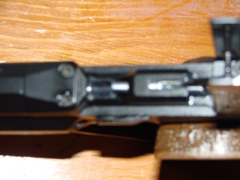

Cocking: pretty easy, you just have to make sure you push the lever all the way forward before pulling it back. It is nice that the loading gate and bolt are pulled back when you pump it.

Other: Has the ability to dry fire which is nice.
The images:
A target I cherry picked out of a bunch, ten meters, ten shots, caliper is at 17mm.
