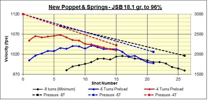

I took some time this evening to shoot some strings with the modded valve at several preload settings.... I used the JSB Exact Heavy 18.1 gr. pellets for all tests, and only those shots within a 4% ES were recorded.... Here are the results....
To say this thing came alive when I drilled the valve out would be an understatement.... The highest velocity recorded was 1028 fps (42.5 FPE) at about 2500 psi with the preload at maximum.... The string is near ideal for a 200 bar (2900 psi) fill, but I can't max. the gun out at that pressure, there isn't enough hammer strike to find out what it would do with the JSB Heavies, let alone heavier pellets.... That string averaged 1012 fps (41.2 FPE) for 22 shots from 2900 psi down to 2120, for an amazing 1.40 FPE/CI.... At 3 turns out, I got 24 shots at 982 fps (38.7 FPE) average, from 2700 psi down to 1930 for 1.46 FPE/CI.... At 5 turns out the fill pressure was 2500 psi, returning 25 shots at 960 fps average (37.1 FPE), down to 1760 psi, for an efficiency of 1.51 FPE/CI.... At the minimum preload, 8 turns out, I still got an average of 931 fps (34.8 FPE) for 23 shots from 2200 psi down to just 1600, with an astounding 1.61 FPE/CI, it only used 600 psi to do that....
I particularly like the string at 5 turns out, from 941-973-941 using a 2500 psi fill to get 25 shots, the longest string.... I know the JSB Heavies are accurate at that velocity in other guns, and they were shooting one-hole groups during the Chrony session, which certainly looks promising.... However, it seems I can never leave well enough alone, so I'm going to pull the valve apart and remove some of the preload by thinning out that brass collar on the poppet.... I can't shake the thought that I can get the same performance without beating the valve to death with such a heavy hammer strike, I would really like to reduce that....

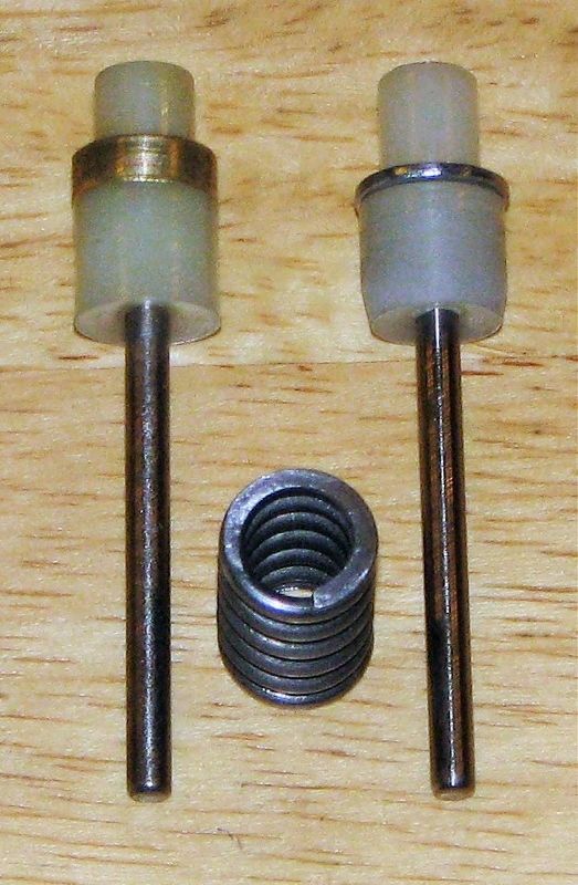

Today I pulled the valve apart again, and worked on the poppet and spring.... I ground the ends of the spring flat, which decreased the length by 0.030".... I made a washer that reduced the preload by 0.095", so I shortened the preload by 1/8" from 0.200" to 0.075".... I had a spare poppet, so I tapered the sides slightly to reduce the seat diameter from 0.41" to 0.36", which doesn't sound like much, but that reduced the force holding the valve closed form 396 lbs. to 305 lbs., so combined with the spring change I reduced the effort to open the valve by 25%.... The changes also meant that the valve could open a lot further without the spring hitting coil bind.... Here is a photo of the old and new poppets, shim, and the spring with the ends ground flat....
I reassembled the gun, and expecting it to need less hammer strike I set the preload to minimum, tethered the gun at 2900 psi, and fired a shot across the Chrony.... 1095 fps with 18.1 gr. JSB Heavies!.... REALLY !?!.... Wow, I guess it was driving the spring to coil bind before, I expected the same velocity at less preload, not another 60 fps!.... I tried all the hammer preload settings, and it really made no difference, the velocity was maxed even at minimum preload.... I stripped the back of the gun apart, took the plastic spring guide I had and turned 0.150" off the preload spacer and tried that instead of the metal one.... Now I could back off the velocity a little bit when I set the preload to minimum.... So, I went digging through my hammer springs and found a couple of likely candidates, and ended up with the ability to at least create a velocity curve.... I took that spring and "set" it by compressing it fully several times, and it lost about 0.1" in length, and I reinstalled it and ran one more test.... The results are in the graph below....
You can see that even with minimal preload the stock spring was too strong.... The new, set spring was still capable of getting the gun to maximum, so I tried a few heavier pellets, with the following results at 2900 psi:

This gun was no slouch stock at nearly 30 FPE, but I have more than doubled that now, putting it amongst the highest powered .22 cal PCPs.... I then hooked my Chrony up to my Netbook using Chrony Connect, and shot three strings with the JSB 18.1 gr. pellets, as in the graph below....
At 4 turns out from my maximum preload setting (with the new lighter, set, spring) the string started nearly at the top and I only got 15 shots.... At 6 turns out, with a 3000 psi fill, I got a normal bell-curve 1004-1041-998 over 21 shots, averaging 1025 fps (42.2 FPE), at 1.19 FPE/CI.... and at 8 turns out (my minimum preload) I had to start the string at 2700 psi, and I got 20 shots ending at 1960 psi, 980-1015-979, averaging 1000 fps (40.2 FPE), at 1.31 FPE/CI.... The efficiency is down a bit, but still very good considering the power level.... I really like the MUCH lighter cocking force, it should be a lot easier on the gun.... If there is any drawback to the gun the way it is now, it is that I can't tune it down enough to get the JSB Heavies into the mid 900s.... There are two solutions, one is to fit a weaker hammer spring and drop the fill pressure down, the other is to fit a smaller transfer port and run the hammer spring at about 6 turns out, which gave me the 1025 fps string above.... From what I saw previously with this gun, dropping the power by dropping the fill pressure doesn't buy you many more shots, so I think I will try a smaller transfer port and see if that will flatten out the string.... I think something about 9/64" (0.140") should put me at about 35-36 FPE with those pellets, so I will start at 1/8", see what I get, and then try and work my way up until the gun is averaging ~ 950 fps where I know those Exact Heavies tend to still be accurate....
When I took a look at the diameter of the stock poppet I knew immediately why the B-50/51 had such a heavy hammer.... I figured that making it a bit smaller would ease the loads on everything, but I was surprised at just how effective it was.... The poppet could be made quite a bit smaller still, there is no reason the OD couldn't be reduced down to 5/16", maybe even 0.300", because the throat is "only" 0.240".... Doing that would, I think, necessitate making a much lighter hammer to compensate.... That's not a bad thing, but I have the idea in the back of my mind to convert my gun to a .25 cal, so the ability to flow lots of air isn't a bad thing, and I have the cocking effort under control just fine.... Oh, I also took some measurements on the hammer throw, and it can be nearly doubled over stock.... The way my gun was tuned from the factory the hammer travel was 0.52", and it is now 0.625".... I can go all the way to 1.00" by shortening the nose of the striker another 3/8", not that I plan to.... You can't machine off all of the nose right back to the shoulder, or that shoulder will hit the cocking pin when it rotates downwards when you rotate the bolt, but that is the limiting factor.... Even with that shoulder flush with the back of the side cocking slot, the back of the hammer is still behind the sear, so I see no reason that shouldn't work.... Increasing the travel to 1" would allow an even lighter striker and hammer spring.... You would just have to watch that with the valve fully open (to coil bind) that the sear didn't catch behind the hammer....

This last bit is excellent Bob, I was scared to touch anything in the valve. I tried to taper the poppet but only halfheartedly, I figured that the spring binding must have been responsible for all those broken poppets but I was guessing and never read anything conclusive when it came to adjusting the valve. Great work!

I didn't remove very much on the poppet, I figured if I needed to I could always go more.... It turns out I'm happy with it the way it is.... Now if I was building a .177, or even a mild .22 I would taper it more, and do a major lightening job on the hammer.... but if anything I'll be going up in caliber from here, not down....
