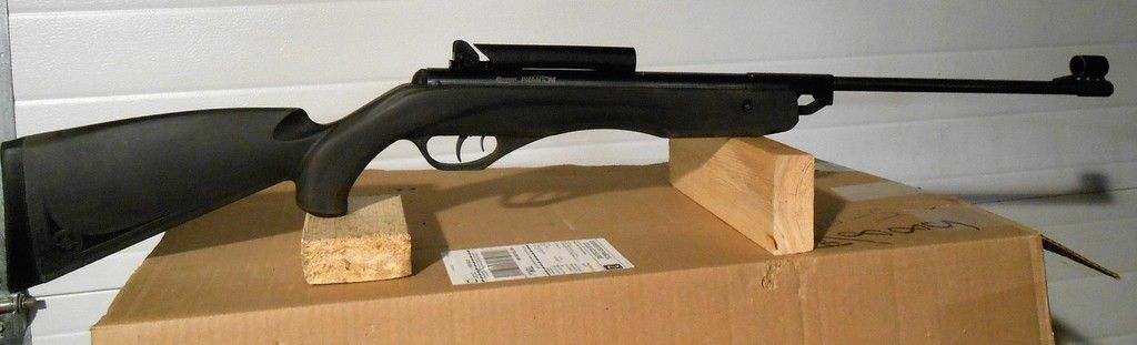

This is my Phantom which Walmart forced me to buy by making it too inexpensive. (So I added a nitro piston to make it more "valuable")
I liked the idea of removing the raised dots, so with a palm sander I did mine too. I had previously cut the fore-end off the stock just for appearance and I lowered the top of the stock to make it easier for me to use open sights. (and I like the look)
I was a bit concerned about cutting too low and getting into the hollow inside the stock, but measurements said it should be ok, and it turned out to be.
The rear peep sight is UTG, (I've found with all 5 of my UTG peep sights, using a 7/64 drill bit rolled between my fingers through the peep hole makes the interior of the sight less reflective.) and the tube in front of it is 3/4" copper pipe split, gripping the dovetail front and rear, and painted black. It helps keep reflections out of the peep sight and is unnecessarily long, but I just thought I'd try a long one and I liked the look of it. Front sight is modified using a piece of M3 pointed bolt and a copper/painted cover.
I steel wooled the stock and I love the feel of it, but I don't know what type of oil to use to make it a bit shiny again. I tried lemon oil, but no go. (But it made my hands and cheek smell nice.)
Peter :D

I like the Armour All idea. If I mask it off and just do certain areas it could look very nice, and be an easier option than clear coat both for application and maintenance.
But that stuff is slippery!
It must have first come out in the 60's because some of us :oops: used it on our steering wheels and vinyl car seats and this was before the days of seat belts. :shock:
All the talk of the Air Hawk stock has got me thinking, and when I get back from a trip I'm taking I may do something about it.
I agree with tango and I don't think strength is a large issue. After the barrel is "broken", I hold the stock on the wrist just aft of the action, and the end of the barrel, so it's the rear bolt that takes most of the strain. (But I've been wrong before.)
Peter :D
