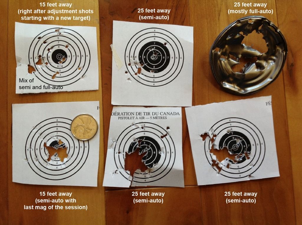

All the shooting has been done offhand, standing up and using the shoulder stock. First I shot on paper targets from two distances: 15 and 25 feet.
Not knowing the accuracy of the MP40, I started at 15 feet to make sure that I would not shoot outside my trap.
From the box, it was shooting a bit low and to the left. Flipping up the second rear sight took care of the elevation. For the windage, I discovered that placing the bullseye in the gap between the front blade and the left air space of the rear sight was giving me a point of impact where I wanted it.
The adjustment shots were made in semi-auto. The next step was to continue the same way for several more shots on a fresh target. Being confident that all the BBs will be kept contained in the trap I proceeded to have several full automatic bursts which were surprisingly bunched close together.
I moved to 25 feet and continued shooting in semi-auto for the balance of the session. The system works well and will not waste CO2 because the trigger will just produce a click if there no BB present in the top of the mag (this mean that the gun stops shooting on the last shot). When a fresh mag is re-inserted, the cocking knob is pulled to make the gun ready to shoot.
With a few full-auto bursts and mostly semi-auto shooting I was able to get close to 4 mags of 50 BBs for a total of approximately 200 without any problem. It should be noted that at the end the gas pressure was not enough to recock the striker, so for the last few shots I recocked the gun by hand for each shot until I felt that it was getting too slow. After removing the mag, I saw that only a couple of BBs were left unfired. When the cap was removed it could be felt that there was some pressure still in the reservoir.
I would say that realistically about good 175 blowback cycles could be achieved.
For my second session, I moved to my garage to engage pop cans. This time I had to split my session in two parts with a gap of several hours. In the first part, I used a mix of semi and full auto for 2 mags and in the second part a few auto bursts and mostly semi-auto. It seems that the full-auto made a difference because this time I obtained only one full mag (#3) before starting to have some problem after only a few shots on the last (#4). The MP40 should not have leaked CO2 during the time I was away, so it is probably the use of the Full-Auto that caused a lower number of shots (about 150 this time).
This would have to be confirmed by trial, but I suspect that using only Full-Auto will probably get 2 mags or less of usable shots.
This picture shows the paper targets covered in the previous text. The pop cans are not shown here but take my word that they were pretty much destroyed. The can lid shown in the upper right corner is from the full-auto test that will be explained a bit later in the post.

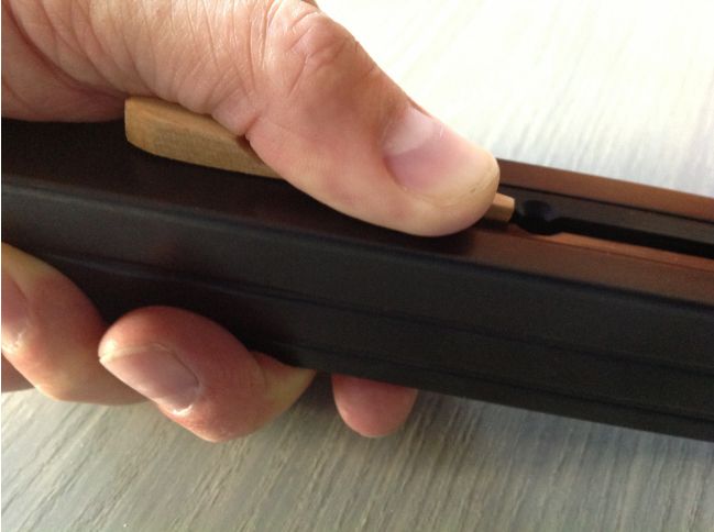

The other complaint is about the lack of lock for the BB follower but it could easily be solved by using a small hook that would help to hold it in place during loading. I made mine from a small left over piece of oak hardwood flooring.
