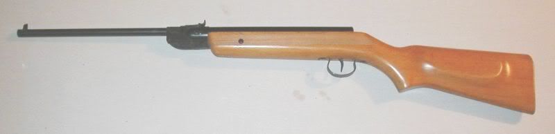

Any one know what kind of gun this is? It says "Made in Hungory".
It was given to me because it is very weak. It looks well made so I am going to take it apart to see what is wrong.

i would guess world famous or gamo but could be wrong .(probly) . i have 2 just like it .(in looks)

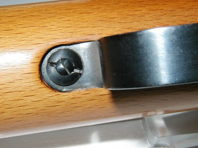

Looks like a Marla .177Cal. .....is there a ajustable trigger screw on the front side of the trigger guard mounting screw?......screw within screw

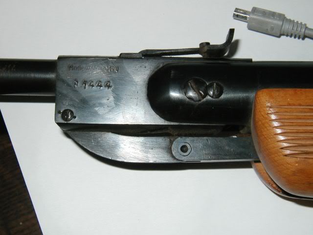

Is this what you mean Parker?
Here is a photo of the breach..................

yup.... looks like a Marla to me ...I've had one for 25+ years....still shoots good......around 470s with a 7.9g pellet.....

Those rifles were sold under a number of trade names - Marla, Jelly, Telly, and a few others. They were generally quite strong shooters, and were of quite robust construction. All the ones that I have had apart had leather piston seals. These can be "revived" if not too badly dried out. If you are in need of a new mainspring, check Princess Auto for one of their "machine gun springs" - it is about the right diameter, and can be cut to length to suit.
