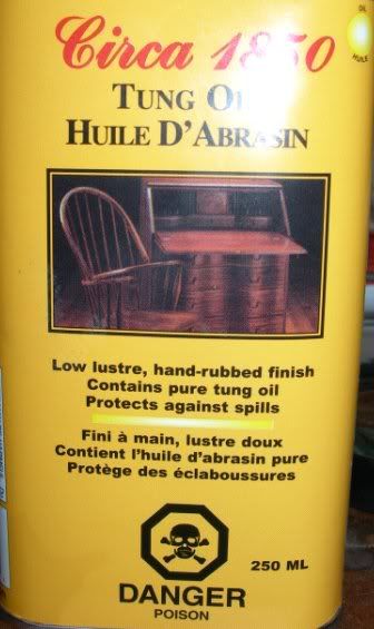

Tung oil is about the best there is to work with and there are verity of finish shinyness you can achive. Take your time to apply it, no rush, no worries making a mistake, re-stroke it if need it to, after covering the whole stock with it wait 10 minutes and wipe the whole stock with clean rag .... 20 minutes wipe again then wait untill the next day to re-do it again. 5 coats is more than enough and the result is beautiful and not shiny.
If you like shiny finish, do not wipe and just let it dry .....
I would recommend it to anybody for professional finish look and easy to use.

Circa 1850 is very cheap, if I wasn't wrong that one is only $7.00 and will do many stocks. Also good to Circa 000 synthetic steel wool is only a couple bucks and works excellent. Circa Tung oil is very easy to use and gives professional finish look. To apply I found that is better to use clean cotton rag, something like from used HANES undershirt .....lol....truely.
[/img]
