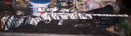

you guys aint talkin bout me are ya??? :lol:
the one made from a paintball gun?
id post pics but apparently i can... :roll:

#10 Post by killercrow »
ok... here goes! but im warning you, this thing is fugly :lol:

#11 Post by hotsky »
What fps are you getting from it?

#12 Post by killercrow »
im not sure right now... cant seem to get my chrony to work for me... my guess would be around 500fps... thats just a guess... it sure hits dem squirrels hard though :lol:
