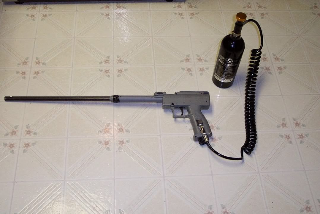

#9 Post by killercrow »
hey ustilago, i appreciate your concern. i did try it out, and no problems thus far... ive seen what a co2 looks like when it pops, no shrapnel. just splits open, now, encase it, and put like 40 odd thousand psi in it, now you have a grenade. LOTS of experimentation with empty co2's. i know i should use a proper adapter... i guess i live on the wild side... :lol: jk
sniper, i'll get pics shortly. right now i cant get my stock on the gun... unexpected obstacle with the new adapter... :? but i'll just do it pistol style for now :lol:
killercrow
Posts: 2374
Joined: Thu Oct 13, 2005 5:20 pm
Location: Spruce Grove AB

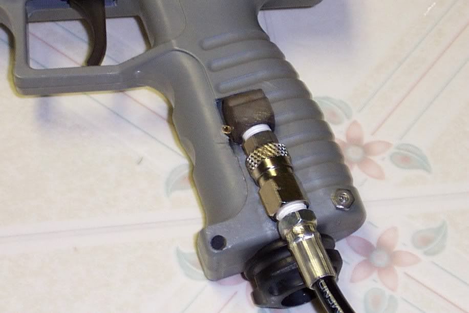

#10 Post by killercrow »
here she is.
note, the little brass pin beside the fitting is just there to keep the co2 from turning.
the plastic frame is temporary... soon to be replaced with brass :twisted:
lmk what you guys think!
#11 Post by sniper »
COOL ...... very ingenuity.
Thx. for the pics.
